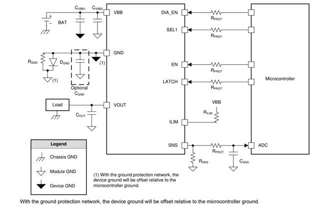

Hello team,
Is ground separation mandatory? Can you explain why ground separation is needed with detailed application?
Austin
  • Hey Austin,
    If there is a upstream diode of reverse polarity protection device then a GND network is not required to be used.
    The GND network is to be used when the an upstream diode cannot be implemented due to the power dissipation.
    BR,
    Alan
