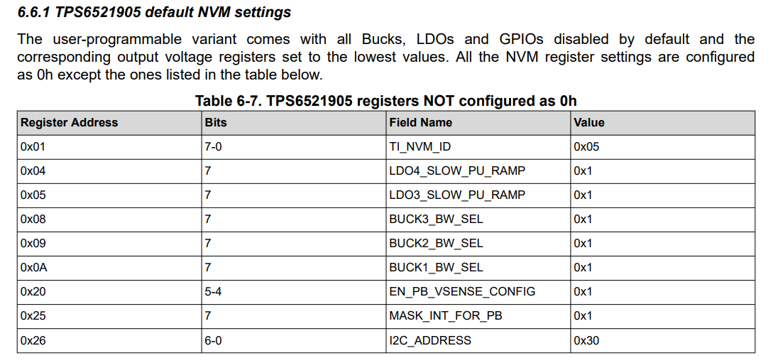

    Default configuration of the TPS6521905 is PB configuration. Push button will need to be pressed (falling edge) to enable the device into active mode.
    However, all Bucks and LDOs are disabled by default. They will not output in active mode since they are disabled.
    The TPS6521905 is a blank configuration, with all outputs disabled by default, and most register values set to 0h.
    The NVM should be programmed before expected use. Or toggle the register settings via I2C to check the performance of the device before burning the NVM.
    The I2C communication should be available once VSYS is supplied, please ensure that you have the minimum hardware requirements as stated in section 2 of the NVM Programming Guide

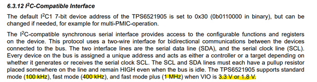

    Are you able to adjust frequency?
    TPS6521905 only supports standard, fast, and fast mode plus (100 kHz, 400kHz, and 1MHz) and VIO level must be 3.3V or 1.8V.
    If there are still issues,
    Check that device address is set to 0x30.
