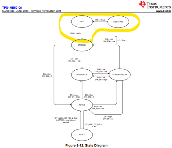

Hi team,
This D/S shows only working mode transition. How this device wake and goes to off? Is this the same as TPS1HB50 state machine?
Shoji
Hi team,
Shoji
Hi Shoji,
Yes its the same as the TPS1HB50 when voltage is supplied the device wakes up and waits for the enable pin to be held high.
