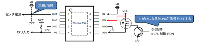

Hi Team,
when the device output is short, PG gets low. However, after the short condition has gone, still PG is low.
What kind of condition, PG get recover to High? such as ADJ off to on
Shoo

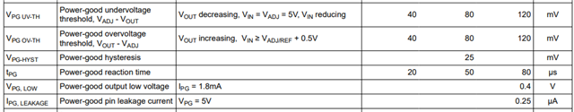

Hi Shoo,
PG is based on a comparator between the out pin and the ADJ pin. Power-good should recover to high within 80us after VOUT reaches within 40mV of VADJ to remain within spec, see V_PG UV-TH and t_PG parameters from the Electrical Characteristics table.
Does PG stay low even after it returns to regulation for a period of time?
Does it stay low after power cycling?

Hi Gregory,
The background is that they changed TLE4254EJS to TPS7B4261 and TLE4254EJS doesn't have independent EN pin. so kind of different operation.
They connect to EN to VCC to return the regulation. but when ADJ is off, The PG goes low.. This is because VADJ < VEN,OFF?
SHoo

Hi Gregory,
yes, pull high again. So the reason is VADJ < VEN,OFF. Could you please show the difference between TPS7B4261 and TLE4254EJS ?
I heard they are drop-in replacement.... but PG and status pin behavior is kind of diffreent.
Shoo
