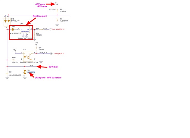

What is the minimum operating voltage of the LM76202-Q1 internal MOSFET?
My VIN is as low as 3V, and I want to set the UVLO voltage to 2.5V.
Hello Gareth,
Your operating voltage is 3V but you need a 32V withstand voltage.
We don't have such device in portfolio right now. It's in our future portfolio road map.
Can you let me know the application? This will help us to define the product.
Amrit
Hi Amrit
The application is automotive alternator control, but it doesn't require automotive standards, but does require halogen-free operation.
The BSP75's function here is to detect high and low levels and then pull to ground. D21 is reverse current protection.
