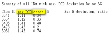

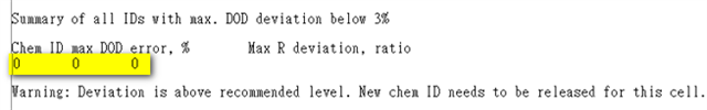

Hi experts,
1. What do chemID max DOD and error mean respectively?
2. If ChemID match max error is Zero, what does it mean?
Thank you.

This is the max depth of discharge error between the cells that you are using for the test, and the chemID. I recommend using the chemID with the lowest DoD % Error.
Jonny.
