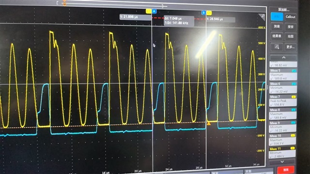

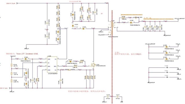

We are facing an odd problem. We found the frequency of the UCC28730 output is not as expected. According to the datasheet, the max switching frequency should be 83kHz. While we measured the frequency is around 140khz~150kHz. We can get this frequency on VGS/VDS and VS pin.
Another problem I'm not sure it is relevant or not. We found the output is not stable, changing following the input voltage.
Could you please kindly help us to advise what reason might lead the sw frequency like this?

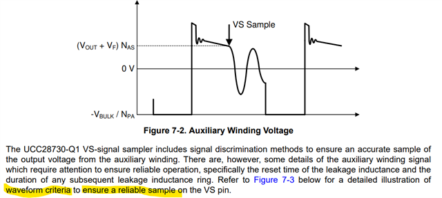

    From the datasheet:
    Looking at your waveform, it is consistently distorted by excess ringing at the sampling knee point.
    The controller is constantly in NSR mode.

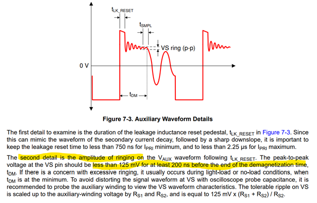

    If you can damp out the ringing from the leakage energy clamp sooner, it should help to avoid this problem.
    I suggest to increase the value of your TVS clamp so the the leakage reset time is shorter (tLK_RESET)>
    Double the reset voltage, for example, to cut the reset time in half.
    Also, if you reduce your Nps ratio for lower reflected voltage, the demag time will be extended and allow the ringing to dampen further.
