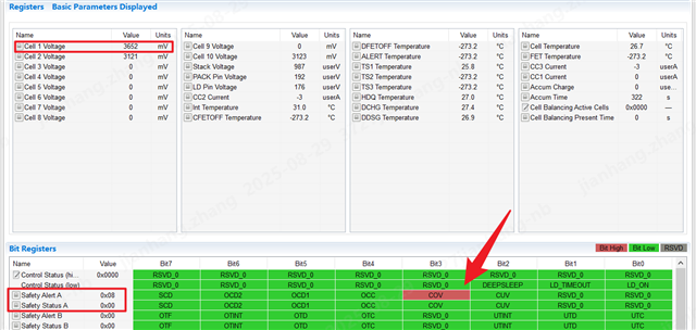

        I've detected an issue with the bq76942. In a three-cell project, the cell overvoltage setting is 3643.2mV. I debugged the single-cell voltage in the first cell to 3652mV, which theoretically triggers a COV fault. However, the register status shows that only Safety Alert A is triggered, not the COV fault in Safety Status A. I need to adjust the single-cell voltage to close to 3670mV to trigger the COV fault in Safety Status A. I debugged only on the Bq host computer (Battery Management Studio) without connecting any other circuits. I tried disabling all Alert registers, but it didn't work. Could the AFE's low number of cell strings affect the accuracy of the single-cell voltage sampling? Please help me figure this out. Thank you.

    As shown in the screenshot I sent, I'd like to clarify again that the Cell 1 voltage is 3652mV, stable, and maintained above the threshold of 72*50.6mV=3645.2mV. I maintained the voltage of the first cell at 3652mV for a duration significantly longer than the delay time of 606*3.3+6.6ms, but the COV status in Safety Status A was not triggered; only an alarm was triggered. I raised the voltage to near 3670mV before the COV fault was triggered. This manifests as the overvoltage protection point lagging the set value by approximately 20-30mV.

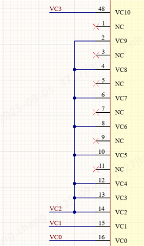

    The device must always have cell connections between VC1-VC0, VC2-VC1, and VC10-VC9. Have you configured it this way? This is further explained in Section 16.6 of our datasheet.

    Yes, I referenced the datasheet to design the schematic, as shown in the attached diagram.

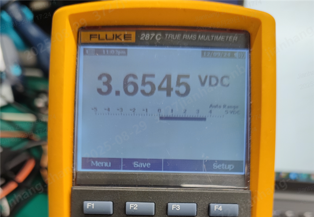

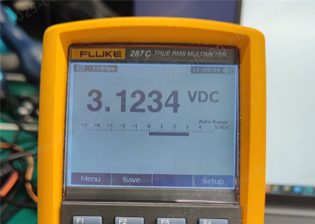

    Yes, I tried measuring the input voltage of a single cell pin with a high-precision multimeter and comparing it with the cell voltage readings on BqStudio. I found the error was only 3mV. As shown in the attached image, the cell voltages correspond to nB0-nB1, nB1-nB2, and nB9-nB10, respectively.
    My cell sampling resistor is 100R, but I tried replacing it with a 20R resistor, but it didn't work.

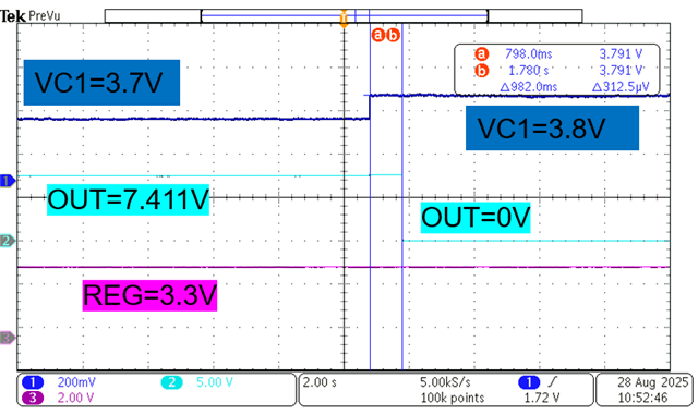

    Can you measure the VC pin, out pin, and REG pin and share the waveform for me? I have demonstrated an example below. The out voltage should drop to 0 when the OVP is triggered. Increase the voltage supply slightly each time over the OVP threshold and let me know at what value it triggers. Measure the delay as well. Your delay is around 2 seconds, so make sure when you are increasing the voltage supply to trigger the fault you are keeping it high for at least 2 seconds before increasing it again.
    The device could actually be triggering a fault for the OVP, but it is not displaying this on BQstudio. We will want to double check this.
