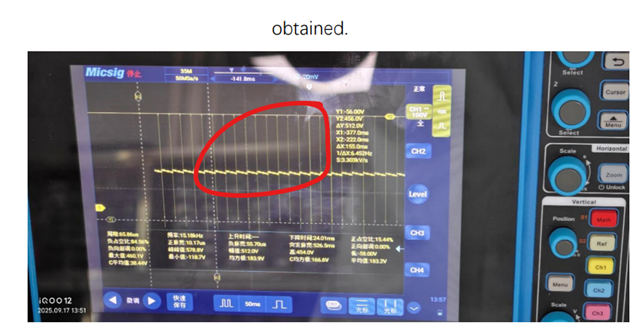

  • Hi Sougata,
    The customer's oscilloscope waveform has been obtained. Please help me to see what the reason is.3326.LLC.pdf
    Kyle

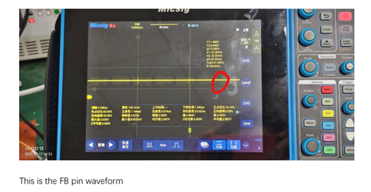

  • Hi Kyle,
    1. I can see lot of noise in ground itself. This is somewhat unusual

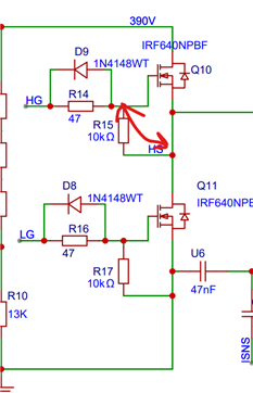

    2. Please let me know how HO have been measured? What the probe points? And while measuring HO, can you tell the customer to probe following points by a differential isolated probe? Then only HO actual voltage can be measured.
    3. What is the level of FB pin voltage as shown below? Is it lower than 5V? Can they check the FB pin voltage at some load i.e. out of burst mode?
