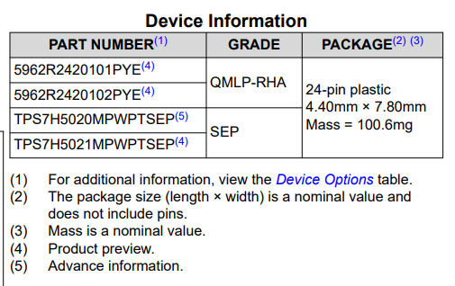

Hello, when is this part projected to enter regular production? How much availability is projected for the part?
Hey Maxwell,
The production release is targeted for the 4th quarter of this year, we expect to have at least a few hundred units in stock
Daniel
Thank you Daniel! Are you expecting to produce non-QMLV versions of this part for evaluation purposes?
Hey Maxwell,
QMLV implies ceramic packaged, which the part is not, its technically QMLP for the higher radiation level:
When we have an SEP grade (lower radiation grade) we don't often do a /EM version that is typically used for the QMLV (ceramic) parts.
We say to use the -SEP grade as the lower qualification part for the -QMLP grade.
Daniel
