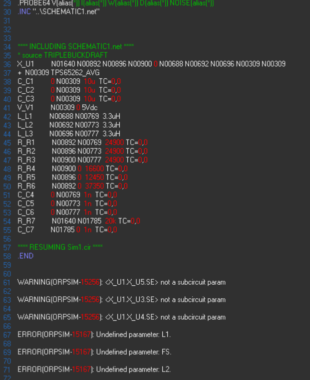

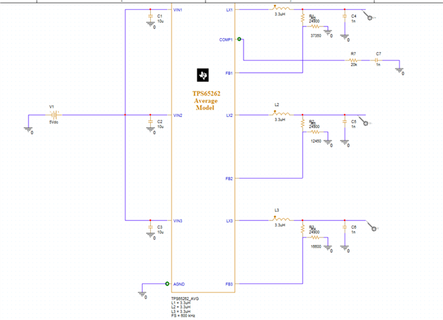

 I am trying to simulate the TPS6526 triple buck converter with a transient analysis and keep running into the following issues. I even tried including a .param table with L1, L2, L3, and FS. When I did this I was able to get rid of the errors but then was faced with an error saying there was an undefined value for param. The errors are not very descriptive however. I know that the TI model for this part expects parameters L1, L2, L3, and FS but after giving them values, the program still cannot seem to correctly assign the values for the inductors and the frequency. Can someone help me fix these issues so that I can simulate the circuit?
