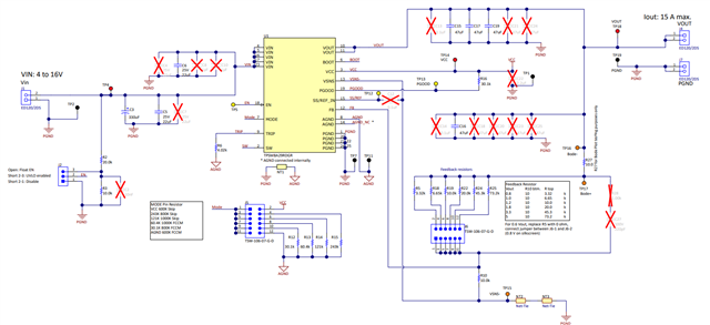

Hi team,
I have 3 questions about TPSM8A28.
Vin: 5V, Vout: 0.75V, Iout(max): 10A

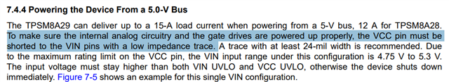

  1. Must Vin and Vcc be connected? Is there anything we should care about?
  2. Should we put Cff for noise reduction? Datasheet shows if Vout= >2V, Cff is needed. How should we decide?
  3. We followed the WeBench recommendations and placed large output capacitors. Are parallel bypass capacitors (for noise suppression) unnecessary?
