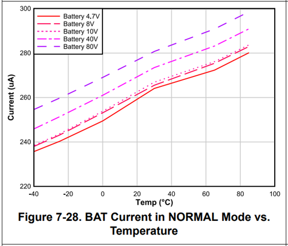

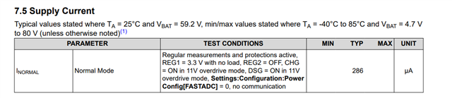

Upon reviewing the datasheet, we noted that only typical values for the operating current are provided. Could you kindly specify the maximum operating current under normal operating conditions for the bq76952? This information is crucial for our design validation and reliability assessments.
Additionally, we are defining production test specifications for this component. Given that the datasheet lacks details on maximum values, what value would you recommend for the production test specification regarding the operating current? Any guidance or industry best practices on setting this parameter would be highly appreciated.
    Unfortunately, we do not characterize the maximum operating current.
    However, the plot below may guide you further. It will give a reference to what you can expect, but the actual operating current may be +/- 50 uA of what is expected.
