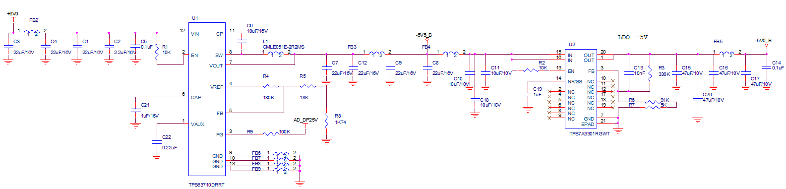

Please recommend an ultra-low noise DC-DC for +15 to -5.5V implementation?
I'm looking to use a low-noise, low-heat, 1A(Max) TPS63710 + LDO (-5.5 to -5.0V).

+6V ==> -5.5V ==> -5V
Will this configuration be stable? Will it operate reliably under heating and low noise?
Hi Lee,
To achieve inverting voltage with low noise for TPS63710, the range of output voltage should be |VOUT| < 0.7 x VIN.
