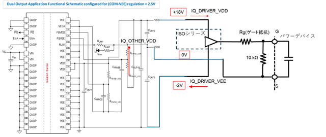

  1. Regarding the currents from lines 17 to 20
I recognize the meanings of each variable as shown in the attached image, is that correct? If I am mistaken, I would appreciate your guidance on those points.
 * IQ_DRIVER_VDD and IQ_DRIVER_VEE: Current consumption on the gate driver circuit side (excluding the switching current flowing through Rg in the attached image and the current flowing through 10kΩ)
(Example: When using ISO5852S, IQ_DRIVER_VDD = IQ_DRIVER_VEE = ISO5852S's Output-supply quiescent current (max) 6mA)
 * IQ_OTHER_VDD: Current flowing through RFBVDD_VEE and RFBVDD_VDD
 * IQ_OTHER_VEE: None (0A)
    I would recommend adding up all of the quiescent currents in your system and adding them to line 17. That being said, your understanding of those currents is correct.
