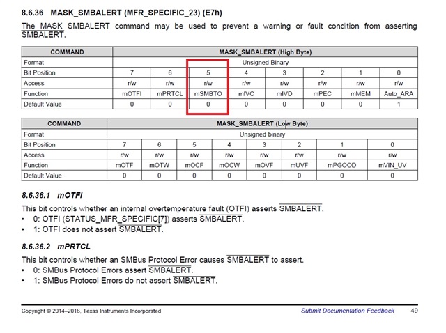

Step 3:
Power cycle the IC and confirm its status.
Expected Result: IC status remains normal and unchanged.
Observed Result: A change in the code was detected.
CMD 0xE7 , write 0x0100, read back 0x2100
