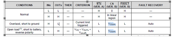

Hi team,
In case of short, the CS output pulled up to VcsH.
The maximum Vcs(H) is 6.5. usually 5V MCU can be tolerant up to 5.5V.
Is there any solution for that? just use voltage devider?

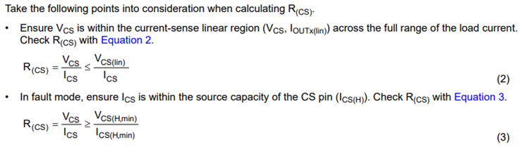

Hi Shoo,
If you are worried about VCS you can reduce it by reducing the value of Rcs:

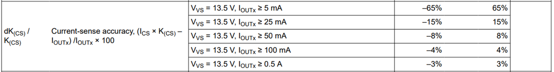

To find your max ICS you can use K(CS) as ICS = IOUT/K(CS)
and to account for accuracy of K(CS) you can use the values given in the data sheet:
Nicholas Petersilge
