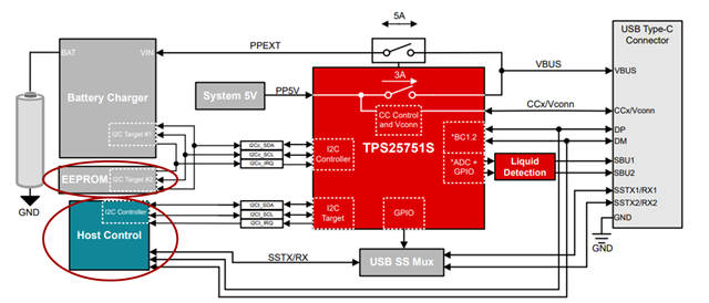

    According to the TI document titled "Application Note for TPS25751 and TPS26750 EEPROM Update Over I2C," please confirm the following connection required for updating the EEPROM patch bundle image via the host MCU.
    • EEPROM with I2C Controller of TPS25751 IC
    • Host MCU with I2C Target of TPS25751 IC
    See the below block diagram from the TPS25751 datasheet for I2Cc and I2Ct connections.
    Can you confirm if the Host MCU is responsible for updating the EEPROM patch bundle image through the TPS25751 IC? Is this the sole method for updating the EEPROM patch bundle image?
    Yes, the TPS25751 is capable of updating the EEPROM image, assuming an initial image is already present on the EEPROM. The method highlighted in the application note referenced is intended for in-field updates. The TPS25751 is not responsible for programming an empty EEPROM.

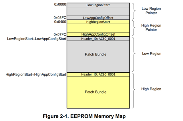

    What is the minimum EEPROM size required for the patch bundle image?
    A full flash binary image is ~32kB.
    • The "low region binary file" is intended for updating the EEPROM patch bundle image via the TPS25751 IC through the host MCU.
    • The "full binary file" is designed for directly updating the EEPROM patch bundle image via the host MCU.
    • Could you please confirm whether my understanding is correct? If not, we would be grateful for your guidance on this matter.
    Your understanding is correct.
    The EEPROM is divided into two regions, high region and low region,  to allow for it being updated without invalidating the previous Patch Bundle until the new Patch Bundle has been verified.

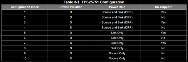

    Following our previous discussion, we have configured the TPS25751D IC patch bundle image with the EEPROM using the Full Flash binary file downloaded from the USBCPD Application Customization web tool. We have programmed various Full Flash binaries into the EEPROM and tested our board with the iPad A16.
    Q1 Select your TPS25751 Configuration

    Changes in to Web GUI (USBCPD_Application_Customization_Tool)
    Full Flash File No. Question & Answer Advanced Configuration Result
    1 Q1 - 2 Index
    Q2 - 15W (5V)
    Q3 - 15W (5V)
    Q4 - Power Source
    Q5 - USB 2
    Q6 - DRP
    Q7 - No
    Q8 - No
    Q9 - No
    Q10 - No
