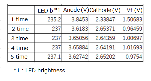

When I use a TLC5940 to illuminate an LED five times in succession, the brightness changes between the first and second illuminations.
There is almost no change in brightness from the second illumination onwards.
The figure below shows the results of measuring the LED anode and cathode voltage (Vf) after five illuminations.
The LED brightness is the value captured by the sensor when the LED is illuminated.
The conditions for illuminating the LED were the same all five times, but the Vf measured after the first illumination was significantly different.
(Question 1)
Is it possible for Vf to fluctuate even though the GS and DC registers are fixed?
(Question 2)
Even though Vf decreases after the second illumination, the measured brightness increases.
Are there any factors other than Vf that cause the brightness to differ from the second illumination onwards?

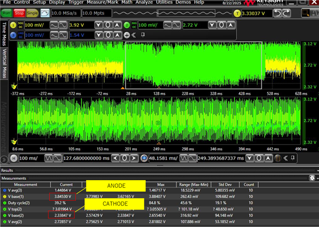

    I received information from the customer about the anode and cathode measurement waveforms.
    The anode/cathode voltage is measured during this period, assuming that the light is exposed for a period between 66ms and 132ms from the start of LED illumination.
    The cathode waveform is PWM controlled, so the voltage during the "L" period is measured, and the anode voltage at that time is also measured.
    In the attached diagram, the anode voltage is 3.53539V, the cathode voltage is 2.65328V, and Vf is 0.88211V.
    Also, regarding the power-on sequence, the power is never turned off during the five times it lights up.
    Also, no registers are rewritten.
    7674.waveform.pdf

    Thank you for your reply and thanks for the waveform you have shared. However, could you zoom in the waveforms in one PWM cycle and put anode and cathode voltage on the same scale? In that case we could see it more clearly and could read the forward voltage more directly on the picture.
    Besides, could you share how you measured this voltage? It would be great if you could draw a schematic of your LED connection and mark where you put your probe.

    It looks like in your waveform, the Vf is low at the beginning, and the oscilloscope regard this as V base, so the measurement of anode and cathode might be a little inaccurate. But we still need more information for measuring and further analyzing about this.

    My customer sent me the enlarged waveform below.
    Regarding the measurement method, the cathode voltage is observed just before it enters the LED, and the cathode voltage is observed at the point where it enters the LED driver.

    Sorry I don't quite understand what "it enters the LED" means here. Can you tell me where this anode and cathode is measuring in the waveform? I cannot see where the cursor is in this figure.
    The waveform here is a little hard to distinguish since the channels are overlapped. Could you tell me where is zoomed in figure is in the first waveform? It would be better if you can put two channels in one voltage axis since now, I cannot see the yellow channel clearly and cannot read its voltage information on this figure.
    You said in your question that there is five times of illumination, could you tell me which time of illumination this waveform is?
