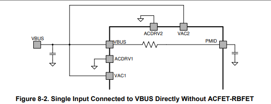

We're using the simplest input scheme for the PMIC, with a 12V input source, and IINLIM=2.5 A:
The actual result we observe is that after connecting the source, the PMIC returns "Not qualified adaptor" state.
Is it an expected behavior? The "not qualified adaptor" message is a bit confusing here; one would expect to receive "unknown adaptor" or "non-standard adaptor".
Regards, Vasyl.
  • Hi Vasyl,
    Are you using the D+/D- pins? VBUS stat is set from the D+/D- detection.
    Is the current limit being set too low for the application because of this?
    Michael
  • Hi Michael.
    We're not using D+/D- pins, and we're setting AUTO_INDET=0 at startup.
    We're setting IINLIM=2.5 A, which in our case yields 30 W, covering the maximum peak consumption with a good margin. The average consumption from SYS is significantly lower, approximately 0.3 A without charging and 1.2 A with a charger.
    Additionally, we didn't observe that DPM active statuses changed after detection, which also suggests that the current limit is sufficient. I can provide the register values if it'll help.
    BR, Vasyl.
  • Hi Vasyl,
    TI is on a US holiday. I think that the "not qualified adaptor" message is because there is no D+/D- detection. I will look into this further tomorrow.
    Michael
  • Hi Vasyl,
    It seems like the not qualified adaptor message is the default state of the register before D+/D- detection. Setting AUTO_INDET = 0 at startup will not allow the D+/D- detection which is why that message appears.
