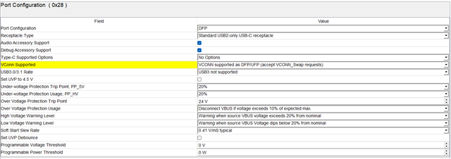

  • Hi Ryu,
    Thanks for the logs. I took a look and it does look like we are sending source caps after a hard reset. For a soft reset, we are not which is expected. This is because we are rejecting VCONN swaps since we are switching data roles. Can you try the following PJT file where I went ahead and enabled VCONN swaps?
    https://e2e.ti.com/cfs-file/__key/communityserver-discussions-components-files/196/Galaxy-A9Plus-Restart_5F00_V100.wmc

    Changing the VCON settings had no effect.
    Ryu.

  • Hi Ryu,
    Does this mean I need to process it externally to resend after a hard reset?
    That is correct otherwise if there is a connection present you could use the SSrC command to send the source caps.
    2. Can the 150-retry interval (approximately 10 seconds) be extended to 20 seconds or longer?
    Please also tell me whether this is possible or not.
    Thanks for the update here with the VCONN swap. Unfortunately we do not have the ability to change the FW to extend this to a different interval level.
