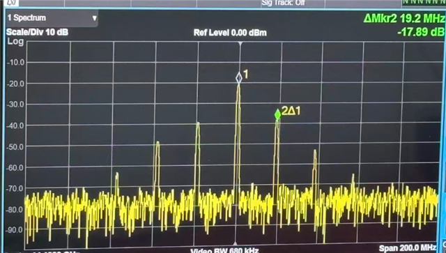

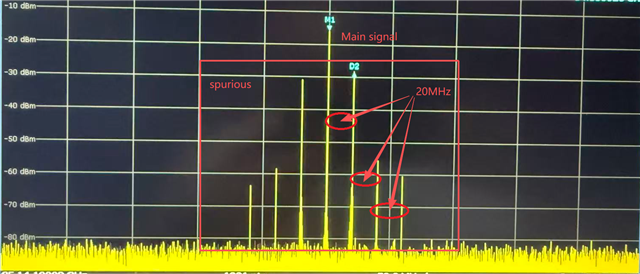

We are currently working on a design using two pieces of LMQ644A2-Q1(4-phase) for generating 1.8V@24A conversion from 24V。There are lots of  RF beamformer ICS supplied by the DCDC circuits. The output current increased as we increase the RF iput power, but when the DCDC ouput current increases to 12A and above, we see some spurious of the output spectrum,they have the following characteristics.
1、About 20MHz、40MHz、80MHz away from the main signal, both upper sideband and lower sideband.
2、The frequency away from the main signal slight changes with the increase of current.
3、The  amplitude of spurious decrease rapidly when we reduce the input power.
4、Modifying the switch frequency does not affect the spurious frequency away from the main signal.
Have you seen this before?  How to remove the spurious?

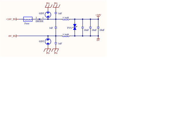

    Is there an input filter to the device? It could have a resonance at 20MHz.
    Ridge
  • Hi Sir,
    Thanks for your answer. Yes,we tried the spread spectrum mode, but the spurious was still there. Significantly, the spurious spreads too.
    And there are some ceramic capacitors, power inductors, TVS, GDTs on the input of regulators.
    Here is my schematic. Could you please review my schematic and give me some advices?
    /resized-image/__size/640x480/__key/communityserver-discussions-components-files/196/Input-circuits.png
    cheng

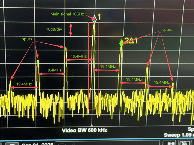

  • hello,
    Today, I remove all the components of the filter to the device, the frequency and amplitude of spurs remain unchanged.
    Here is the image of the spikes with spread spectrum on, the spurs change a little.
    By the way, is it possible and  the spurs are related to the load, the load impedance is 6 ohm.

    /resized-image/__size/640x480/__key/communityserver-discussions-components-files/196/Spurs.png

    What is the frequency of the main signal?
    Is it at 20MHz, or are the signals just 20Mhz apart?
    Ridge
    The main signal is about 10GHz.

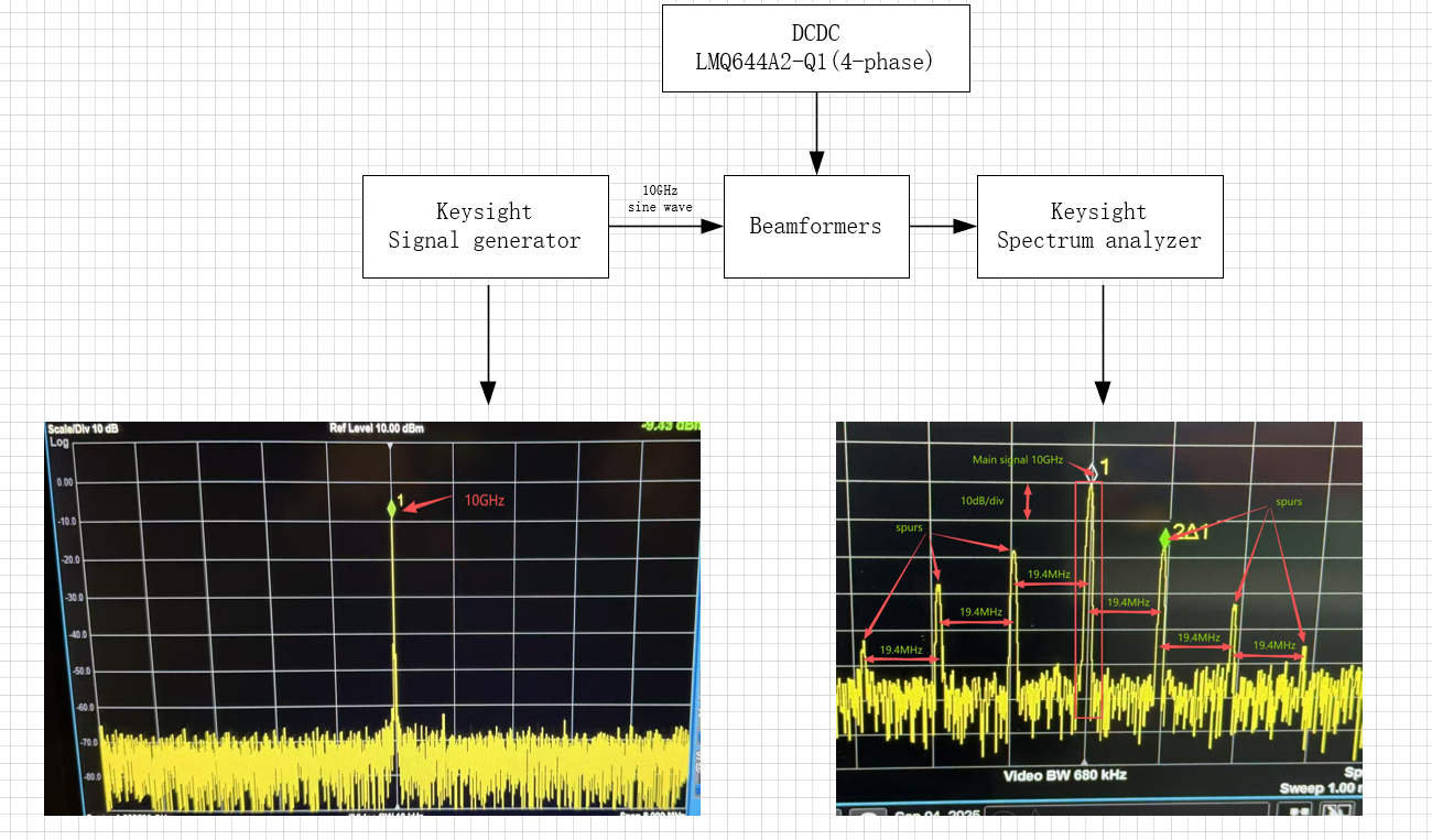

    I think What I said may not be clear enough.
    Here is the system block diagram. THe 10GHz is the signal we wanted and the spurs are unexcepted.
    /resized-image/__size/2600x1526/__key/communityserver-discussions-components-files/196/7457.system-block-diagram.png
    Yes, every signle chip has four 1nF ceramic capacitors near the power supply pins. There are 32 chips, so that‘s mean 128 pieces of 1nF decoupling capacitors downstream from the buck converter before the radar chip load.
    I have measured the ripple at both the output of the buck and at the point of load using an oscilloscope, the waveform appears to be normal.
    cheng

    Finally, after many tries, the spurs has been removed  by changing the decoupling capacitors of beamformers from 1nF to 1uF.
    It has nothing to do with the power supply.
    Thank you for your support.
