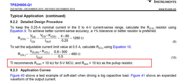

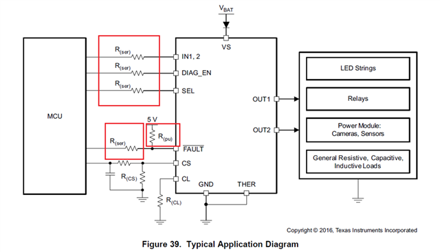

Hi Expert,
Have a nice day! I have question need your professional support:
For TPS2H000-Q1, why the resisters connected to signal pin are recommended to use 10kohm?
How to calculate the R value? What is the min value?
Thanks!
