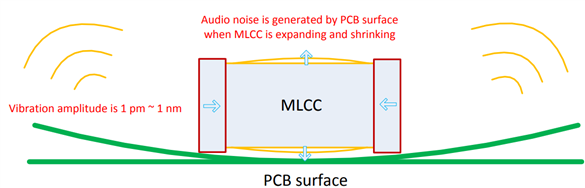

    Origin of audible noise:
    Multi-layer Ceramic Capacitors (MLCC) is widely used in electronic products due to its good performance, such as small size, low ESR, low cost, and so forth. However, when an AC voltage is applied to MLCC, it expands and shrinks due to the electrostrictive effect of the ferroelectric ceramic. As a result, the printed circuit board (PCB) vibrates in the surface direction as shown below. The vibration of capacitor and board is only about 1 pm – 1 nm, when the vibration frequency reaches the audio frequency range (20 Hz – 20 kHz) of humans, a sound is perceived by the human ear.
    The inductor also has similar electrostrictive effect, but it is not common to observe the audio noise generated by the inductor with the advancement of inductor process, especially for the shielding inductor.
