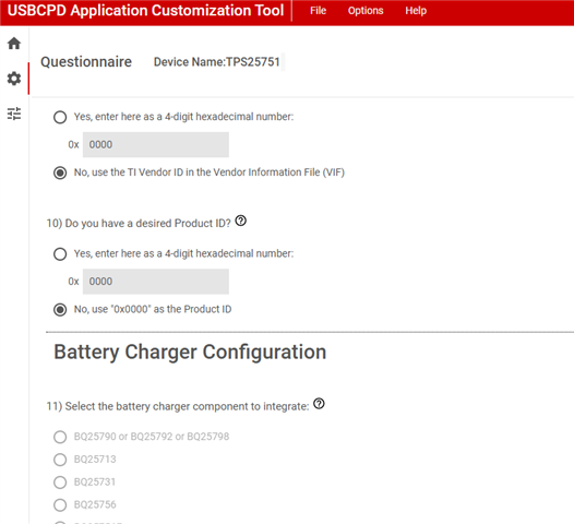

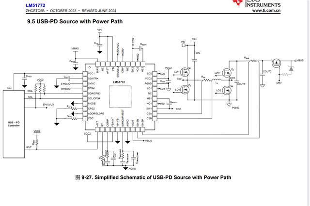

I used TPS25751 just for PD Source 45W application and the dcdc module LM
51772 is chosen.  Since I saw this diagram in LM
51772 datasheet, I suppose this is feasible. But when i use USBCPD application tool, I can only saw BQ chips.
I am wondering how TPS25751 could communicate with LM51772 for 9V,15V voltage adjustment according to PD negotiation.
