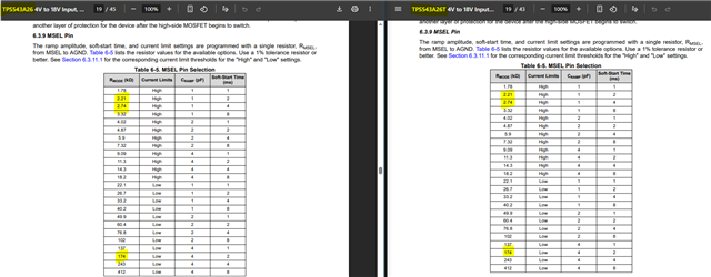

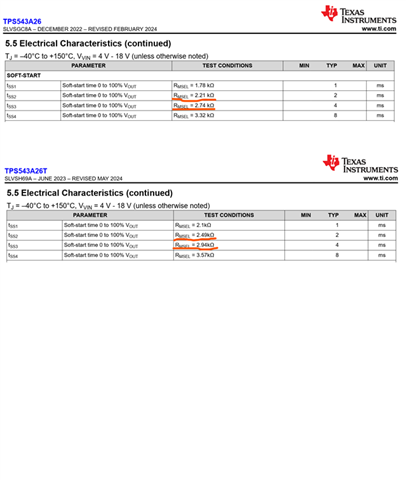

I have an existing design with TPS543A26. The design uses Rmode = 2.21k, 174k and 2.74k to select soft-start time = 2ms and 4ms. Can I use TPS543A26T in place of TPS543A26 retaining the Rmode = 2.21k, 174k and 2.74k?
