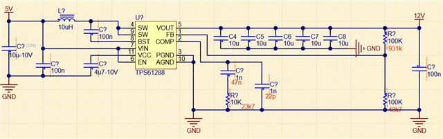

TPS61288: 5V to 12V Boost Design for 100mA Output Current.
Part Number: TPS61288
Other Parts Discussed in Thread: TLV61047, LM2733
In our project we considering to use TPS61288.
TPS61288 is capable of higher current ratings but we only need 100mA output when boosting 5V to 12V.
There is a limited space in our PCB so can I use 74438336100 coded inductor from Wurth?
Also could I connect enable pin directly to the VIN?
