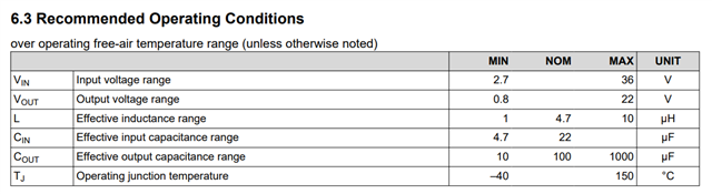

TPS55288: capacitance value as a load for TPS55288.
Part Number: TPS55288
Please let me know if there are any limitations on the capacitance value as a load for TPS55288.
