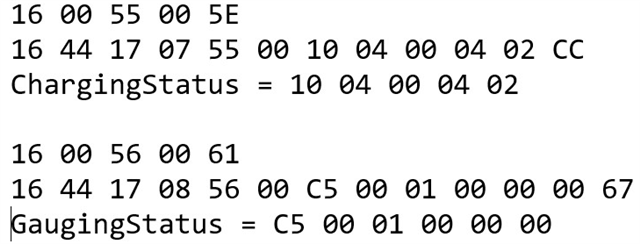

Hi Team :
As shown in the screenshot below.

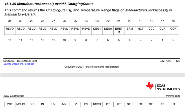

I read the data 0x0055, I found that the response length is 5 Byte  , but TRM specifies is 4 Byte length .

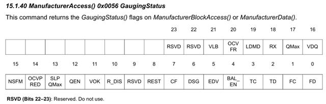

I read the data 0x0056, I found that the response length is 6 Byte  , but TRM specifies is 3 Byte length .
Could you please clarify how I should interpret these results? Is there an additional parameter or condition that explains the difference?
Thank you for your support.

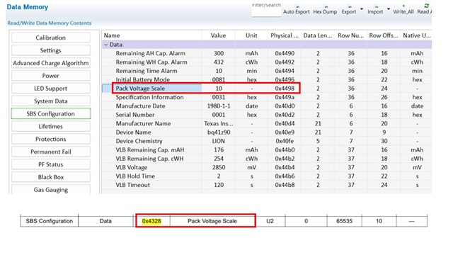

  • Hi Alan:
    I have another question. The function name addresses in the TRM  is differ from the address in bq-Studio.
    For example, the address of Pack Voltage Scale in the TRM is 0x4328, but in bq-Studio it is 0x4498.
    Could you please provide the correct and updated Data Flash table?
    Thank you。
