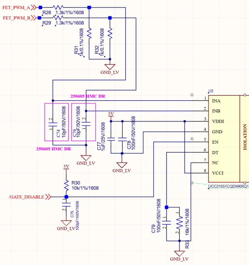

First, before I ask about the UCC21551, let me briefly describe our topology as follows:
1. Topology : PSFB Converter
2. Swtiching Frequency : 96kHz
3. Dead Time : 150ns
4. Circuit
Now for my main question: Will there be any problem if I design the INA/INB input filter like the attached circuit, which is different from the design recommendation in the datasheet below?
we've implemented an RC filter with 1.6kΩ and 10pF, which results in a cut-off frequency of about 10MHz.
My question is, are we allowed to use values other than those specified in the datasheet's recommendation? I would like an answer on whether it is acceptable to apply our current filter values, even though they deviate from the recommendation, and if this will cause any problems.
I look forward to your prompt response.
thank you.

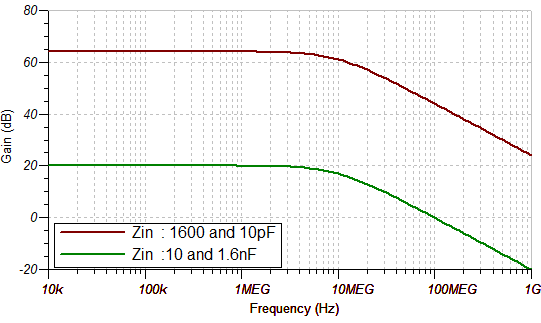

    Yes, this will be a problem. I do not recommend more than 100 ohms of filter resistance for your input filter. Could you try a 1.6nF, 10 ohm filter instead? Even though this the RC filter frequency is the same 10MHz as for a 1.6kΩ and 10pF, its source impedance is 160x lower vs frequency, and it will absorb transient noise injection with a much lower voltage rise. Consider a simulation example of a 1A transient injection vs. frequency:

  • The PWM source (UCC28950QPWRQ1) in the circuit I designed has a 12V output. Therefore, I used high-value resistors to create a voltage divider. Considering both resistor power loss and the source current, resistors in the range of several kilohms seem to be the optimal choice for my circuit. If you can, please tell me the applicable C (capacitor) values when using resistors in the several kilohm range. and in my opinion, a large RC filter value will just act as a signal delay, and as long as I account for that, it shouldn't be a problem for the design

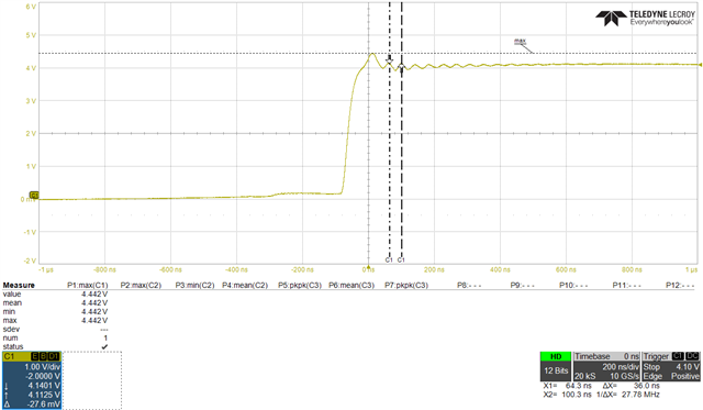

  • I changed the filter resistor from 1.6 kΩ to 1 kΩ, while keeping the capacitor at 10 pF, and measured the waveform to check for high-frequency ringing and its peak amplitude. The measurement was taken right at the PWM input pin of the gate driver, and I confirmed this under 100% load condition on the actual converter.I don't see any potential for signal distortion or any issues that could damage the chip. Wouldn't the current design values be acceptable?

    10pF is not much, especially with a 1k Ohm source impedance. How much power is running through this PSFB?
    But if it works in your circuit at 100% load then it works! The ringing in your measurement is not bad. Just make sure there are no positive transients above 1V on this input when the other channels are switching. It seems you understand the potential noise issue well enough to make the judgement.

  • The maximum power rating is 2.3 kW.
    As you can see in the waveform captured with a wider time scale below, no surge voltage exceeding 1V is observed, even while the other channels are switching.Thank you for your excellent feedback. Lastly, here is the wide-view waveform.
  • You are welcome and good luck on the rest of your design.
