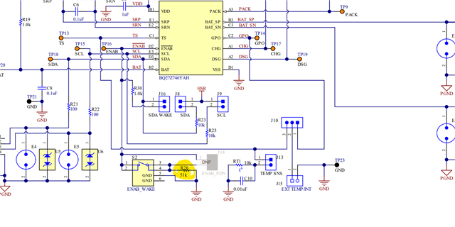

BQ27Z746: BQ27Z746 ENAB wakeup threshold observed higher than datasheet spec
Part Number: BQ27Z746
Hi TI Team,
We are testing the ENAB wakeup function on the BQ27Z746 using the EVM.
The datasheet specifies that the ENAB pin voltage must be pulled below 0.4V to wake up the device from Shutdown mode.
However, we modified the EVM resistor R26 from 51kΩ to 470kΩ. With this modification, when pressing the switch, the ENAB pin voltage only drops to about 1.2V, and we still observe that the device wakes up (confirmed from PACK output).
  • CH1: ENAB pin voltage ≈ 1.2V after pressing switch
  • CH3: PACK output voltage shows device wakes up from Shutdown
Could you please clarify why the device wakes up at around 1.2V on the ENAB pin instead of below 0.4V as specified in the datasheet?
