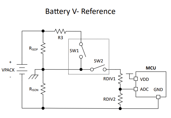

In the datasheet of TPSI2072-Q1, you are presenting 2 different topologies for the monitoring of the insulation resistance (Battery V- reference or Chassis Ground reference). I am interested in the Battery V- reference design, using a B79631 as suggested in the datasheet. However, there are no example providing typical values for Rdiv1/Rdiv2 or R3. Could you elaborate on how to compute those values and select correct resistors for this ?

  • Hello Collin,
    Thank you for your patience and reaching out with this insulation impedance detection circuit with TPSI2072-Q1.
     In the diagram you showed, RsioP and RsioN represent the health of the physical insulation on the HV battery in the system. When the Physical Insulation of the HV battery is healthy (undamaged),  RsioP and RsioN will be in the Mohm range. When the Physical Insulation of the HV battery is damaged, RsioP and RsioN will be in the Kohm range. Therefore, measuring the values if RsioP and RsioN allows us to check or guarantee that the Physical Insulation of the HV battery is undamaged. R3 and Rdiv1/Rdiv2 are selected based on accuracy and High Potential testing considerations in the above architecture.

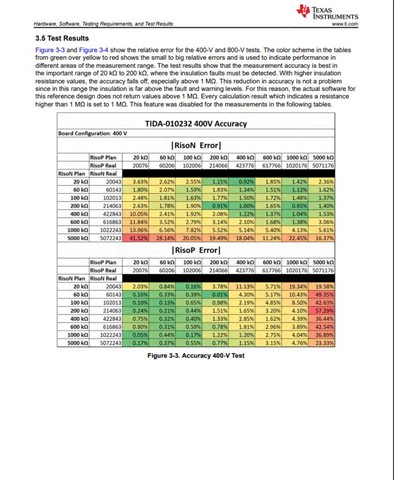

  • Hello Colin,
    Page 26 of the design guide shows that the measured accuracy is best when the resistors (%0.1 precision) are selected to be close in value to the warning/fault resistance range of the isolation resistors [warning (500 Ω / V d.c. - 2mA); and fault (100 Ω / V d.c. - 10 mA)]:
