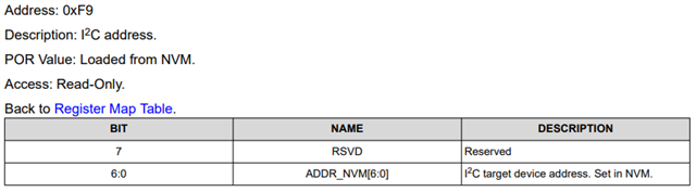

I am using the TPS38700S-Q1 and I was wondering why the sequencer address is not correct?
In the datasheet it is written 0x3C and it answers at the address 0x07.
Could you tell me why? Is there any impact on this?

    Just to confirm, could you please let me know the full part number of the device you are using?
    Also to confirm, are you able to read the value in register 0xF9 as described below:

    The full part number is TPS38700603SRGERQ1.
    I confirm that I read 0x07 in the 0xF9 register.
    Could you tell me if this address which is normally a reserved I2C address can have an impact?
    Why do I have this peculiar address?

    That is definitely a bit strange as the I2C address should be 0x3C as per the datasheet.
    I am double checking with the team, but in the meantime, does this issue persist across multiple devices, or is it only for 1 device?

    I just double checked with the team, and the correct I2C address for this device is actually 0x07.
    The datasheet has a mistake which I will work with the team to fix.
