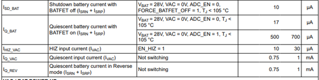

I am working on a design using BQ25751 and would like to ask if there is data available for the approx quiescent current for DRV_SUP?
My design has VAC approx 12V, so I plan to use diode-or to use either AC or battery voltage (clamped to 12V in accordance with datasheet recommendation) for the gate drive supply, rather than the REGN LDO.
I do not find a value of Iq of DRV_SUP pin in the datasheet, so I worry whether in a scenario where the AC supply is disconnected and the system is off, the battery could be drained through DRV_SUP.
