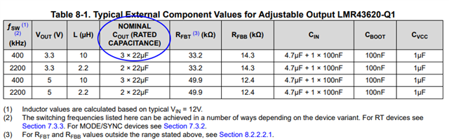

The datasheet suggests the typical external component values in below table.  Customers have the question on the output capacitance.
3*22uF or 2*22uF is the nominal capacitance values or the rated capacitance values under the output voltages?
