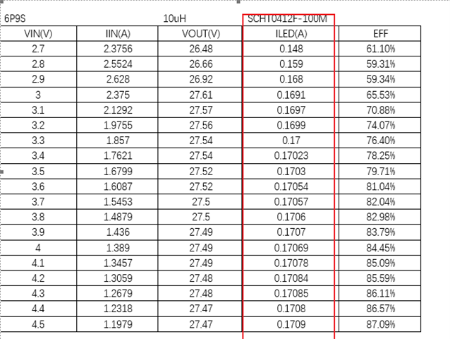

Lenovo tablet team want to use LP8556 to drive a 6P9S, a LED panel with 6 LED series.  69PS has the following spec, I see with 3V input, 28V output, the required current is 170mA.  Is LP8556 able to drive this LED?  I see in D/S with 3V input 24V out, we can only have 140mA.
