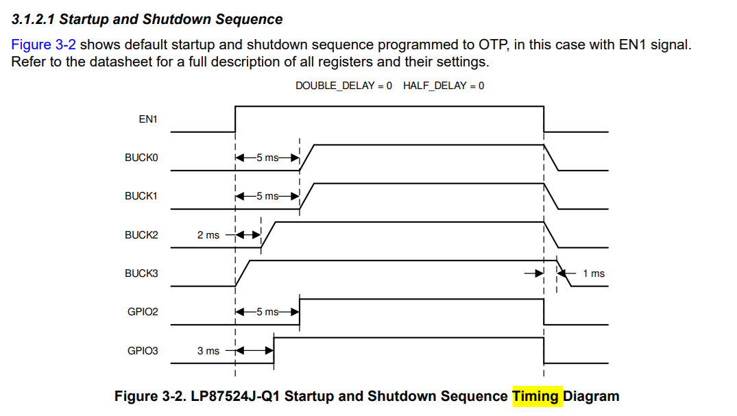

1. In this process they want to check functional block diagram (which is more specific than page 15 of datasheet) and timing diagram which includes reset and en signal.
Could you check it?

    Functional block diagram presented in the datasheet is the one I would refer but we do not have any other. From the timing diagram, did you mean device power up and down sequence timing and related settings then those can be looked into the Technical Reference Manual (TRM); Link

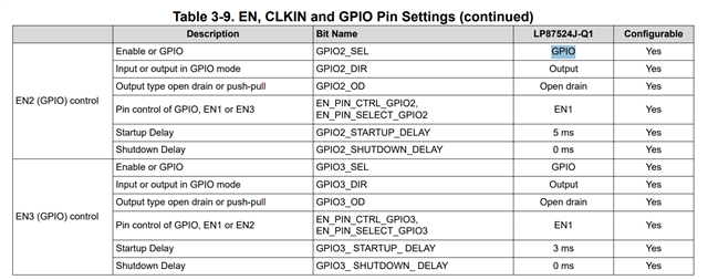

    1. What is the default setting of EN1, EN2, EN3 pins without I2C connection?
    For now, the device is working only EN1 is high. (with other combinations-only EN2 high, only EN3 high, EN1,EN2 hign,....-device does not working.)
    2. In the schematic of AWR1843AOPEVM, I can see that ENx pins are pulled up. Is it necessary if I2C is not connected?
    Please check this issue. Thanks.

  • Hi chase,
    In LP87524J-Q1, the EN1 is configured as ENABLE signal for power up and down sequences of all buck regulators and GPIO2 and 3.
    Where as the EN2/GPIO2 and EN3/GPIO3 are both configured as GPO output signals and they are also enabled by EN1 with start up delay sequence and other settings shown in the TRM below.
