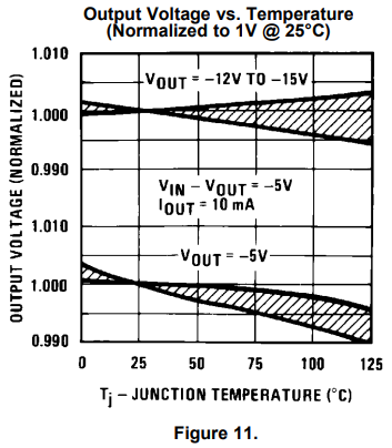

    However, we do still have characterized temperature performance for many of our devices (see LM79L below)
    This isn't the same as a min/max spec for ppm/'C, but gauging from this graph, the -5Vout version of the LM79L may exhibit -100ppm/'C which is outside your spec.

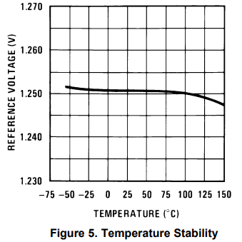

    A more detailed graph of temperature dependence can be found below:
