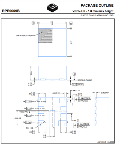

Is LMR36506 wettable flanks QFN? It seems both package is available from package outline (RPE0009A/B) but there is no description which PN is wettable flanks or not.

Hi Koyo,
Both would have wettable flanks.
Niranjan
Hi Koyo,
I checked with the product engineer. The ePOD with RPE009A only has step cut wettable flank, the other one RPE009B does not have.
Apologies for the confusion.
Niranjan
Hi Niranjan,
Customer prefer non wettable flanks package but I see PRE0009B is not available for LMR36506.

Hi Koyo,
RPE0009B is for the non-Q variant of the device and does not have wettable flanks
Q variant has RPE0009A, with wettable flanks
Niranjan
Do you mean LMR36506RRPER is not wettable flanks?
First page of LMR36506 datasheet (non Q1) describes this is wettable flanks, so let me clarify. Sorry for rushing but we need an answer asap.

Hi Koyo,
This is the feedback I got :
Customer will get only the non WF variant since 2023. WF is not in production anymore for this catalog device
So for the non-Q variant they will get the one without wettable flanks now.
