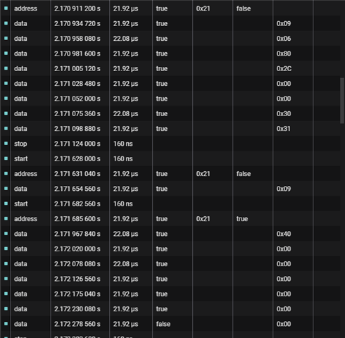

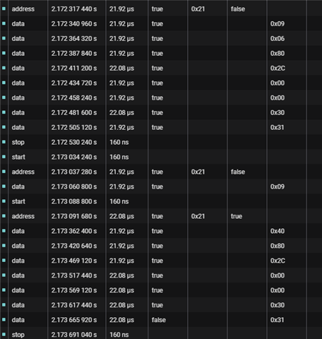

TPS25751: TPS25751. Device accepted the patch bundle and not switching from PTCH to APP mode.
Part Number: TPS25751
I use TPS25751 no eeprom.
In my board,It did not use the pin of I2Ct_IRQn.
I read the file TPS25751: Embedded Controller (EC) to Load a Patch Bundle Directly to the TPS25751. Device accepted the patch bundle and not switching from PTCH to APP mode. - Power management forum - Power management - TI E2E support forums.
I blocked the interrupt level waiting code。// while (HAL_GPIO_ReadPin(GPIOE, GPIO_PIN_4) != GPIO_PIN_RESET);
when upload path, the tps25751 can not act the address 0x30.
/****** STEP: 07 ******/
tps25751_upload_patch(patch);
the iic send 0x30<<1, get nack.
please help me get the reason.
tks.
