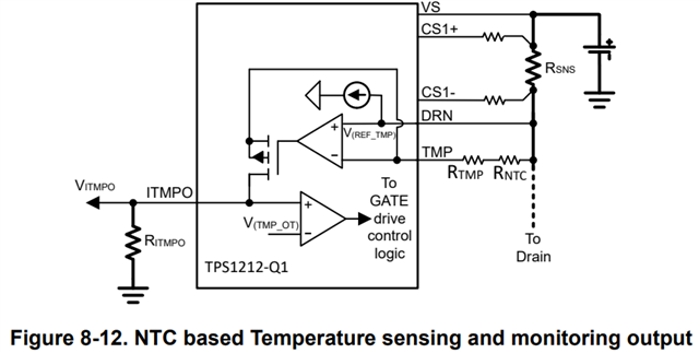

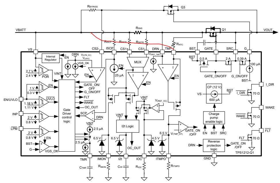

Does the TMR pin have specific voltage range requirement, or it can be connected to any power rails which between -60 to 73V?
Does the TMR pin must be connected to between Rsns and MOSFET? Can we connect the TMP pin to VBAT or other power rails? And if we must connect the TMR pin and DRN pin together? Thanks.
