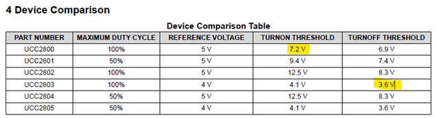

I confirm about duty.
but not of TURNON THRESHOLD and TURNOFF THRESHOLD.
Which IC to choose from UCC2800, UCC2802, UCC2803?
I have UCC2803, It seems it does not drive Power MOSFET(IRF840), or I am missing something.

    These devices are general purpose PWM controllers, and as you mentioned the main difference is max duty cycle, Vref voltage and different turn ON and turn OFF thresholds, which depends on the VDD voltage. Based on that you can pick any one of them.

    That's because the Vgs is low enough to turn on the MOSFET, what's the VCC you're providing to the IC? The OUT will follow VCC.
    Some PWM controllers have a maximum 50% duty cycle due to microcontroller timer limitations, where the timer's design or firmware logic divides the cycle into a fixed number of time slots. Hence, we provide customers the option of 50% or 100% max duty cycle with diff turn ON and turn OFF thresholds.

    UCC2803 will turn OFF below 3.6V and turns ON above 4.1V, so any MOSFET which has Vgs over 4.1V will work.
    For that AC/DC converter they can pick any device expect UCC2802 and UCC2804 as their turn ON voltage is 12.5V.
