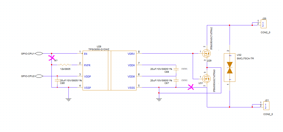

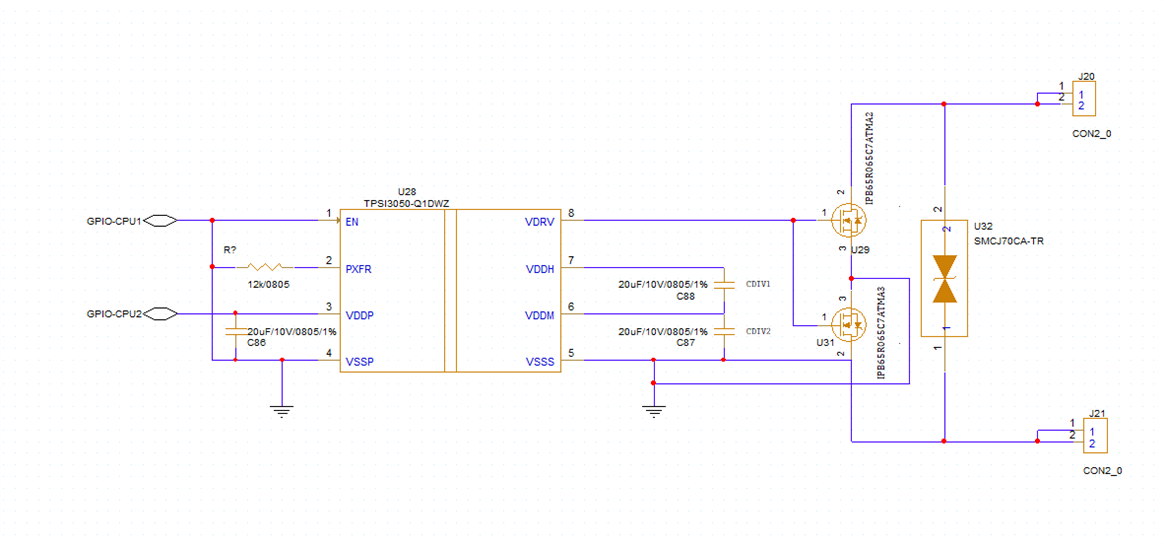

Hi, I have doubts using this diode please verify and answer for my schematic .
  • Hello Gokulkumar,
    Thanks for joining E2E and reaching out to our team!
    I'd recommend checking in our calculator tool and also simulating using the PSpice model to verify it can meet your application requirements.
    At a glance, I think you will need to disconnect EN from VSSP as this will keep EN low always. And disconnect U31 MOSFET drain from VSSS as this will short across the MOSFET.

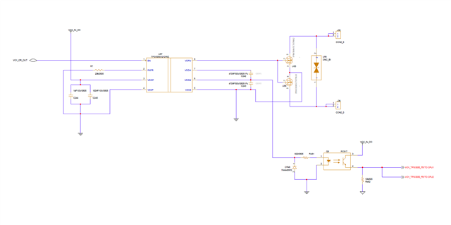

  • Hi ,
    I modified my previous circuit and added an auxillary circuit from the VDDM pin ,Is that my circuit able to generate a 5v feedback signal from the VDDM pin and also verify my circuit all the components connected properly.Please reply what are the changes should be included in the above circuit ?
                                                                                                                              Thank You
  • Hi Gokulkumar,
    Thanks for your reply.
    I'd recommend taking a look at TPSI3100, this device has same features as TPSI3050 but also power good (PGOOD) feature to send back-channel communication from secondary-to-primary and notify VDDM is high.
