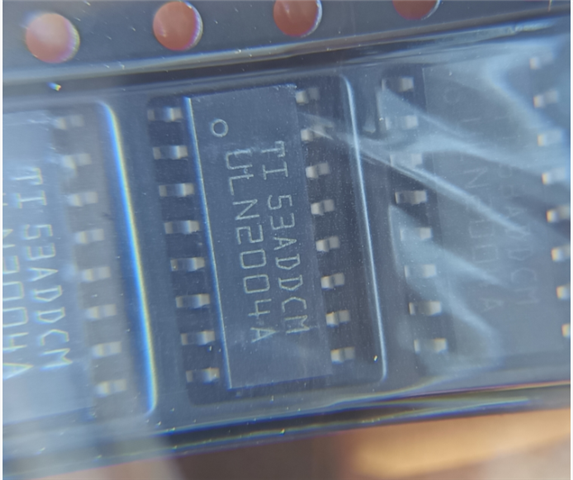

We find the screen of ULN2004ADR show that 53ADDCM,but the DC is 2431,so we want to know What does the screen "5 "represent?
pls kindly find attachfilescreen and DC information ,thanks.

Thank you for your reply. The customer still wants to know if the 5 on silk screen represents the year of packaging , and if DC2431 displays the year of wafer?

Are there any units in that reel that are from 2024, indicated by a "4" as the first character in the topside marking?

Thanks for your support,all the the first character in the topside marking indicated by a "5",the label DC is 2431,"2024",so the customer think not match,pls kindly help to check,thanks.

Are you sure these devices came from the package with this label? And, are you sure there is no material with other date codes in the reel?
What probably happened is that there are devices from different lots batched into this reel - we're following up with the relevant team to confirm this.
Patrick
Hi Ning,
This has happened because of how the units were fabricated, and this is expected.
