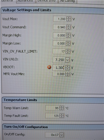

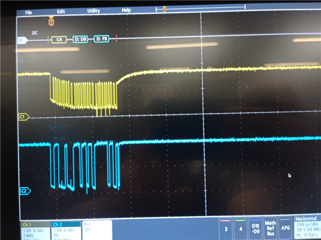

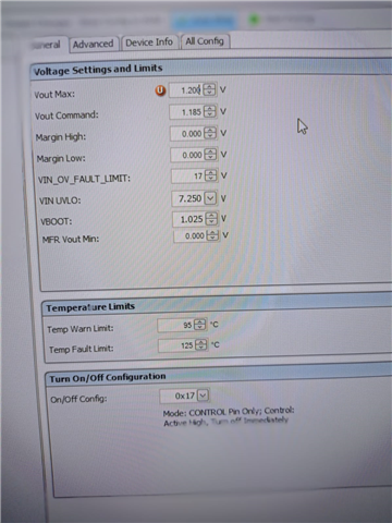

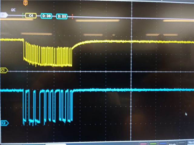

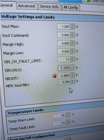

    Thank you for your response. Let me explain the steps I followed:

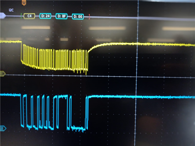

    • First, I set VOUT_MAX to 1.200 V. I verified this with the oscilloscope, and the value was correct. Then, I measured the output voltage at the power stage (driven by PWM) with a voltmeter, and I observed 1.030 V, as shown in the screenshots below.

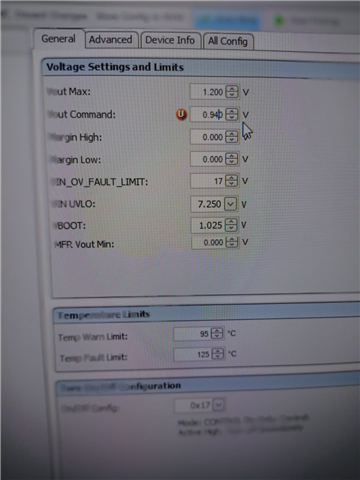

    • Next, I set VOUT_COMMAND to 0.94 V. Again, I checked with the oscilloscope and the voltmeter, but the output voltage still showed 1.030 V without any change.

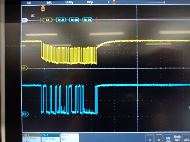

    • Then, I set the VBOOT value to 1.5 V, and I observed the output voltage correctly as 1.507 V, also confirmed by the screenshots below.
    • Finally, I set VBOOT to 1.300 V, and the output voltage was correctly measured as 1.306 V.
    In summary, the values written to VOUT_COMMAND do not affect the output voltage, while writing to the MFR_SPECIFIC_11 register directly sets the output voltage — even if it exceeds the VOUT_MAX limit.

  • Hi Muhammet,
    When you change the output voltage using VBOOT, it is likely that VOUT_MAX has been reset to default (higher) value and not updated in the GUI. This would create the behavior you see where by using VBOOT the output voltage can be raised above VOUT_MAX, because the actual VOUT_MAX in use by TPS53647 is higher than what is shown in the GUI.
    You can check this by using "Device" -> "Refresh All Parameters" to command GUI to re-read all values from TPS53647 device. You can also use "Refresh All Parameters" to check whether the VOUT_COMMAND value in use by the device was updated properly following the attempted write.
    Do you see this behavior on multiple TPS53647 controllers or on other boards? Or can it only be reproduced using this specific controller?
