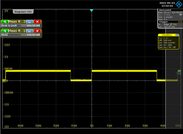

  • Hi Eric,
    Below is a scope shot of the ILIM pin before the 1.1A current limit is hit, which seems correct:
    After drawing more than 1.1A and hitting constant current mode, I see the current oscillation down to 500mA-700mA and a corresponding oscillating signal on the ILIM pin:

  • Hi Adam,
    Sorry, I should have been more clear.  Can you show a scopeshot of the output current?
    The ILIM pin will show DC voltage for normal operation.  I'm not entirely certain why we would see these 1ms dropouts on ILIM.  The routing should be okay as you described it.

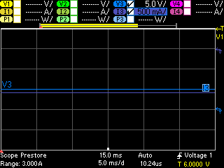

  • Here is the current into my CC load right before the TPS2553 goes into constant current (~ -1A):
    As is shown, the output voltage at the load is ~5V.

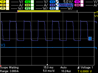

    Here is the current into my CC load once the TPS2553 goes into constant current:
    Output voltage drops to ~0V (as expected), and the current has the oscillatory behavior.
  • The oscillation is usually due to thermal shutdown.  The device limits current until the die reaches thermal shutdown and the switch completely opens.  Once the die cools down, the switch will re-enable and the cycle repeats.
    I don't see an issue with the current limit level.  Am I misreading the plot? I3 appears to go to -1.1A during the current limiting phase of the cycle.

  • Ah, oscillation due to thermal shutdown makes sense. I was able to verify this by observing the output spend a larger duty cycle at -1.1A at cold. Thank you for the help!
