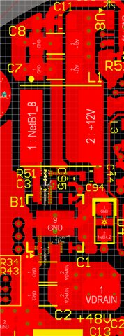

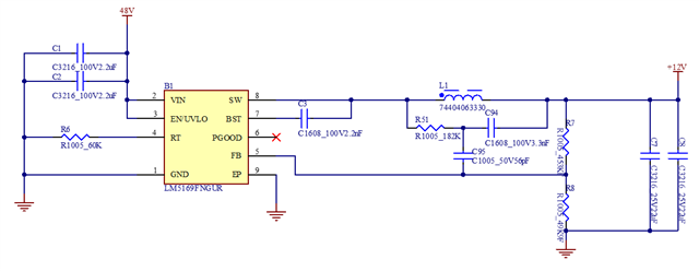

It's a circuit using 48V to 12V using LM5169, but I keep getting the problem of dying.
The 48V is buried with the motor power end and has 5 10uF bypass caps.
The 12V output terminal is in use for internal power supply of the STEP DOWN board.
I'd like to get some help regarding the above.
  • Hello Jarim,
    Is the motor at the output?    Are you sure you don't have excessive voltage back feeding to input - when motor stalls are breaks?  Thanks.
    If so, please a blocking diode between VOUT and Load.
    If this is not the case, please provide me with your specification and fill out calculator spreadsheet so I can review specification and check design against it.  Thanks.
    David.
  • Hello, David
    The 48V input terminal is buried in the battery and has a maximum of 70V specification, so it won't be a problem because the regulator input spec (120V) is.
    Then, are you saying to add a diode to the VOUT stage 12V output stage?
    If that's right, we'll add it and test it.
    Thank you.
  • Hello Jarin,
    I am asking about your load.  Is it a motor, i.e. high inductance, if current is abruptly stopped, you will experience a voltage across the load that cause current to conduct in the reverse direction from NOUT to VIN.  If this is the case a diode will help.
    David.

  • Hello Jarim,
    please use a low forward voltage drop diode - Schottky.  let's check that we can prevent failure first, then decide how we are going to fit it in.  thanks.
