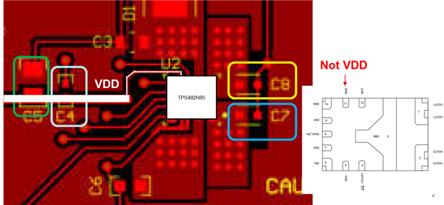

I have a question about TPS482H85 pin configuration and EVM layout.
When I take a look at EVM layout, VDD is connected to pin11.
However, datasheet Figure 5-1 pin configuration shows pin11 is GND pin.
Please let me know which one is correct, figure 5-1 pin configuration or EVM layout? and Please share the correct information?
Kai
  • Hi Kai,
    Thank you for bringing this to our attention!! You are absolutely correct, the datasheet figure is wrong; it is technically showing the bottom view. However, the pin numbers do match. The Altium layout is correct. This will be updated before RTM.
