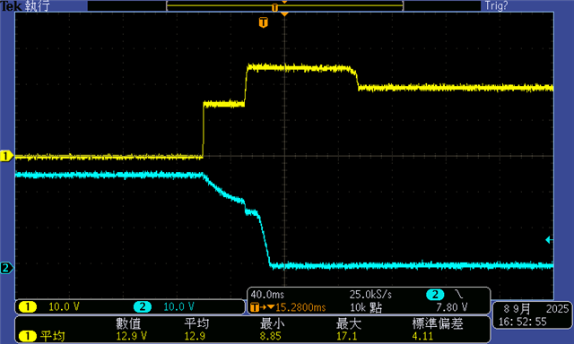

With the same RC soft-start, when VAC is plugged in (adapter re-applied) while load remains on VSYS
The device transitions to forward operation (BATFET OFF, ACFET ON). During/after this transition the BATFET is damaged (burned).

  • VAC = 13.5 V, VBAT = 16–18 V. Only the BATFET fails. Even after replacing the MOSFET, it often fails again—still only the BATFET. The ACFET shows no abnormalities. I’ve reviewed the material you provided; it only addresses the inrush current issue. Adding an RC has resolved that, but it does not cover the BATFET burnout problem I’m encountering.
  • Hello Allen,
    Got it. Thanks for the new information. There might be shoot through from the ACFETs to the BATFETs. Would it be possible to graph BATDRV and ACDRV when VAC is plugged-in?
    Also, could you use a diode in parallel with the ACFETs RC to increase the turn-off strength?

  • Hello Ethan,
    Based on our latest tests, the contention/overlap between the ACFETs and BATFETs is confirmed. Given this, should I also add a soft-start to the ACFETs?
  • Hello Allen,
    Thanks for the lab tests.Are you measuring ACDRV and BATDRV with a normal measurement or differential measurement? Which channel is ACDRV and BATDRV?
    Adding a softstart to the ACFETs may reduce the overlap. You could also add a diode to bypass the BATFET's gate resistor and help pull the BATFETs to GND faster.
    Ethan Galloway
  • Hello Ethan,
    Since I don’t have a differential probe on hand, I used conventional single-ended measurements of both gates with respect to GND. CH1 (yellow) is the ACFET gate/ACDRV, and CH2 (blue) is the BATFET gate/BATDRV.
    I also tried placing a diode in parallel with the BATFET’s gate resistor to strengthen the turn-off, but the MOSFET still ended up damaged.

  • Hello Allen,
    Got it. The single ended measurements are not a problem. I just wanted to make sure I was reading the waveforms correctly.
    Can you measure the SRN/SRP and ACN/ACP resistors? These resistors can get damaged in a current surge. These resistors might still be damaged after replacing the FET.
    For your system, you might have to add soft-start to the ACFETs or reduce the soft-start of the BATFETs. Will either of these options work for your system?
