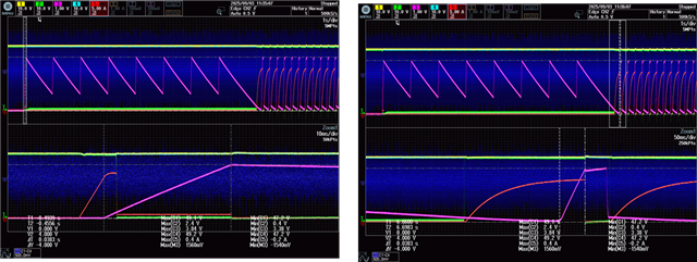

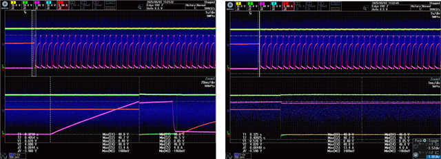

Hello, we found unexpected behavior in over current protection.
We are meaasuring with electronic load and followings are detail.
When we set the current as 16A , it worked fine and started restart sequence.
But after 8 counts, it looked trying to repeat turing on and off.
perhaps it is because electronic load was keeping trying to sink 16A current.
But when we set the current as 15.5A, the hotswap looked trying to repeat turing on and off from bigining.
-Wave form with 16A setting (CH1: Vin, CH2: Vout, CH3: Vtimer, CH4: Vsense, CH5: current)
-Wave form with 15.5A setting
We would like to know what is happened when it is repeating turning on and off.
Pararell of 7mΩ (3.5mΩ in total) is used for Rsense.
